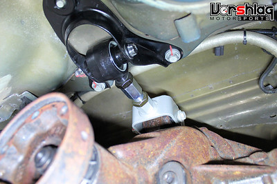

Duh! I just noticed that Falken has a 315/30r19 available. Decision time. I think I would need to relocate the rear bump stop bracket and run at least -3* camber to get the front tires to tuck under the fender well. I have 19x11 ET50 wheels and I think I might need to run more spacer on the fronts (go from a 20mm to 25mm maybe). Anything else I need to consider in order to fit this much tire under both ends of a S197 Mustang?
Hmm, not sure you will need to do this bumpstop relocation kit.
We did it on our 2011 GT when we ran an 18x12" wheel that we tucked inboard a lot, and your setup might not need it. It is the wheel barrel that can touch this piece at full droop (on a lift)...
If it isn't rubbing now it won't with the wider 315mm tires... it was the wheel barrel that touched, not the tire.
