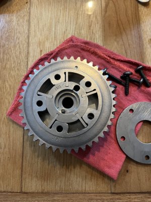

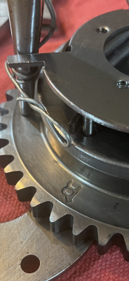

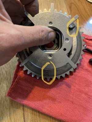

Woke up this morning & said “Forget work, I’m gonna build a longblock!!” Talked to Lito, got lockouts yest….here we go!!! I take the 1st phaser off the cam, and start removing plate bolts….but “WAIT””, there’s pressure on two of these bolts…ahhh screw that, yank them out!!” Then a POP and that’s when I knew I’d screwed up! What do I do now? Trust me…I’m pissed enough at myself, let’s moved past that…I’m still trying myself!!
1. The hook (yellow) has to get back around to the R…is that even possible for me to do?
2. Do I even need to worry about it? Aren’t I “locking out” that function anyway? As long as I get pressure on it will it be ok?
3. I still have my old phasers, should I just use one of those?
I’m so pissed but it’s my own stupid fault!

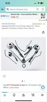

Getting a new timing set is an option but it would kill me. I’m not happy with this kit I got from MMR. I had to cut and grind some of the plastic to get the chain guides to fit correctly. One of the spacers is too small but I think the factory one would work….but it’s not the right one for that guide.
This ad says it’s the “updated kit”…can someone educated me on this? What’s updated? Hoping my MMR kit is an old version and this one fixes the issues

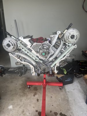

I think I got it all ready to go. Gonna go over the bolts again with torque wrench. Can’t seem to find trigger plate anywhere…dammit! Any tips installing the timing cover and oil pan? Think I need to dab some sealant on head to block cracks. Gonna watch a few vids on oil pan & timing cover replacements to see how it’s all being sealed best! Not as fun as I thought but it’s all working out

Anywhere there is a seam/joint/two halves meet you want to use a small amount of RTV. I like The Right Stuff from permatex
