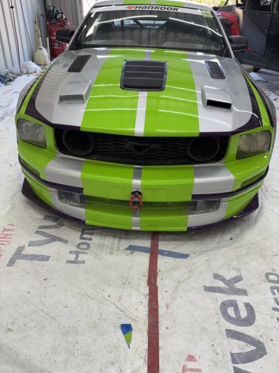

im just here asking about the hood ,,,
is that 2 scoops put on the hood ?
ive neever seen that before..
is it functional?
