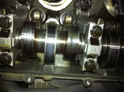

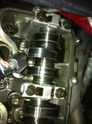

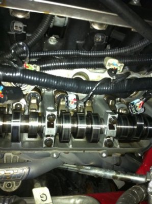

Ok, let me start out with does this look normal

They look fine to me?

I thought my 127350’s looked a bit beat just like yours but then checked a few other cars and that seems to be normal. I’m not thrilled with it but normal.
