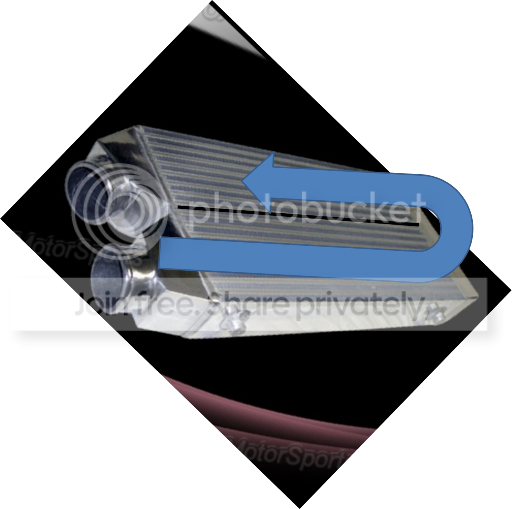

They make intercoolers with same side inlet/outlet but flow vertically. If there is a problem with your intercooler now, it's trying to flow everything through half it's height, but twice it's length.... if you catch what I'm saying.

I understand what you're saying and I completely agree. I'm just trying to find one of those intercoolers that I can get to work. Without spending $900 on the hellion one.

You can see the way the tubes of the core are orientated. If you look at his intercooler that's on the car now, you will see the tubes going horizontally and if you follow the airflow, you will notice that that only half the intercooler is used, then the air makes a u-turn, and comes back through the other half. THat alot of small tubing to be pushing air through.
I "think" that even a cheap vertical flow one would be way better than what you have just because you are cutting out the insane amount of inches the air is traveling in your current intercooler. Like this:

The fins will be vertical instead of horizontal and the end caps will be on the top and bottom instead of the ends.
So how is that different from mine?
Is it because mine are different
You're blowing in through your entire 1,000^3 core (a guess) then out.
The Zimmer core is split. We are blowing through a 300^3 core, reversing direction and blowing through another 300^3 core.
It is just way to small for our turbo and HP.
