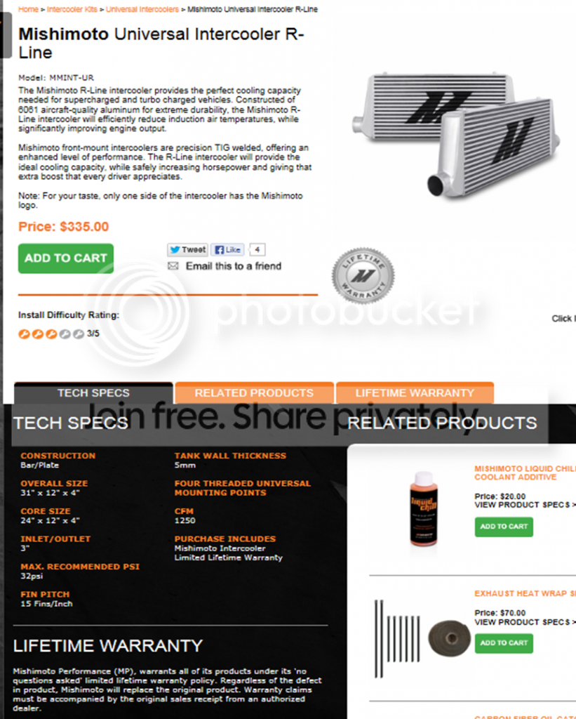

Well i might have the same problem..i have a 9psi spring and i was only getting 5psi. I had to place some washers in the WG to force it to 9psi. Since i got it to 9 i really didnt care and left it alone.i havnt tried that home depot bypass lol but i have a feeling its gana be that IC.iv checked and replaced everything else.
