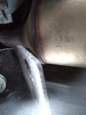

Hi. New here and new to Mustangs. I have a 2006 Mustang GT. I am fairly confident that the car has exhaust mods. From the front tire back, it is just pipe. By the front tire and angling upward is the large thing in the picture. Is this the catalytic converter? There is one each side. The front of the car is on the right in the first pic. Thanks.exhaust 1.jpg exhaust2.jpg exhaust2.jpg

Yes those are your cats. 3V's have two, one for each cylinder. There should also be some O2 sensors bunged in there. As for the straight pipe, it is just pipes back until after the rear axel, then should be a muffler. Sounds like the PO did a straight pipe axle back setup. Hard to tell in your photos but is that an H or an X? It should be an H to be the factory catback. I'd get some mufflers back on there in the back.

Take a picture of the pipes under the rear bumper, someone here will probably recognize which system the car has. If it does have muffler deletes and if you don't like it, you can probably find a stock system on a local online classified site for beer money.
