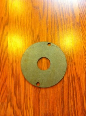

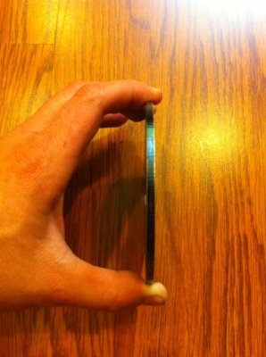

redstangs9308gt
Dec 8, 2008
1,251
Ok so I over nited my spacer from Ram to here and this is what I got. It looks to me like this is going to be perfect. Thanks Ram. Jermey I would highly suggest you to wait and let me put this in. Maybe it will save you some money on labor. All this has costed me was UPS +14.99 and my sweat. And well a few cuss words. LOL Im going to go start the process. Hopefully I can get xpipe, starter, torque limiter and driveshaft removed tonight.
