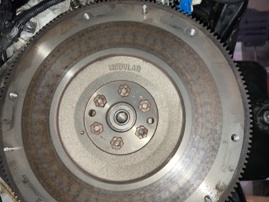

before I start putting all the stuff together again... Does it make sense to change the flywheel ? The PP and the flywheel show those "colored surfaces ".. the besides the " imperfect color " the surface of the flywheel ist smooth.. I still can feel /see the little lines ( feels like a LP Record from my teen years ) ...
As for the preload of the TOB I will try to get 0.750 " of preload - so the TOB will stay right in the middle of the travel., and when the clutch gets older,/ wears down , there is enough room to compensate the fingers that will come out / towards the Tranny side. Have some spacers now.. but both will either bring the preload to 0.617. or 0.937.... ( the existing preload is 0.417" right now ..not enough for a safe operation of the TOB )..
Will ask in a machine shop, if they can reduce the 0.520 shim I got from Summit down to 0.350"
never thought that a simple clutch change can bring so much headache with them... I ve owned so many cars in my life... 99 % stick but this Stang is the first that uses such a crazy clutch construction..
JC SSP
Nov 8, 2022
2,327
1,388
FL
I strongly suggest resurfacing the flywheel with any new clutch replacement.
