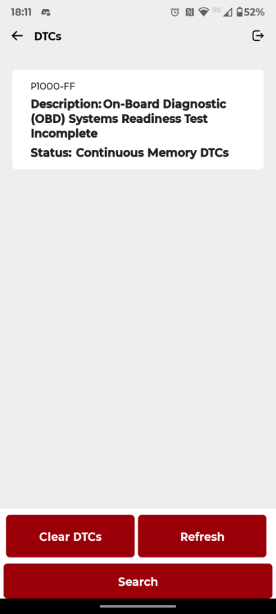

Engine runs beautifully Dino, absolutely no issues except this other code but i think it was generic as car hadn't done the relearn for fuel trims yet? I'm not sure its running at full power although I cant tell as I dont want to push it yet.
I did clear the two DTC,s three times now. The codes come back as soon as I restart and rev it a few times but the CEL doesn't come on until I do at least 10 miles but thats maybe the way it operates? I have the car up for MOT on Wednesday and dont want it the CEL coming on during the test as thats a fail. I did make sure on friday that nothing was hindering the linkage from moving freely connected to the charge motion plates
Yup, that's just a generic code you get after the battery's been disconnected and the ECU hasn't completed its adaptive learning cycle.

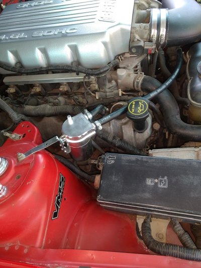

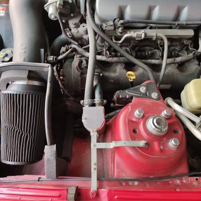

Catch can goes on the drivers side on a 4.6L
And if u use 100% synthetic, it will not collect very much... 1/4". Use semi synthetic, and it will fill to the top.

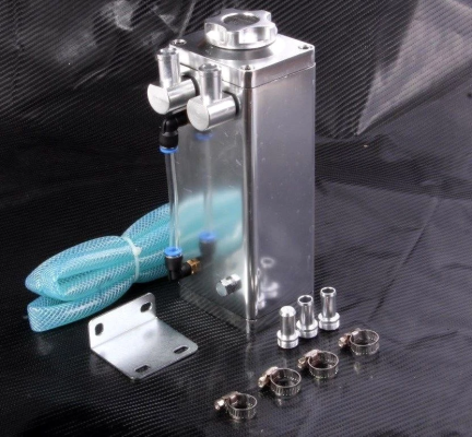

Ordered this one as its local, I have black piping in the garage which will look better than that clear piping
