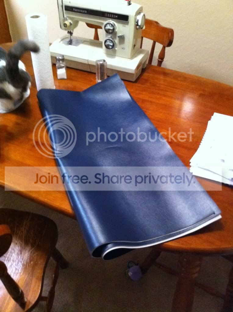

im redoing mine this weekend, gonna use a marine vinyle that looks like leather, ill post pics when done

metoo picking up a real dark blue, at joanns, gonna also putb a stripe in my shift boot with same color. its going on my sonic blue
ok, now I def want pics! Joanns? Like the fabric store? I think I have one of those near by.

here it is
