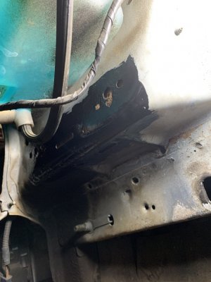

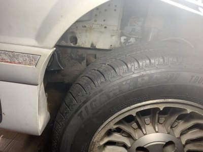

In the meanwhile, I managed to make a little bit of progress using the POR 15 on the area underneath the battery tray (wheel well side). Unfortunately, I didn't think ahead and planned poorly with brush usage, so I have to wait until I get some more brushes before I can get to the engine bay side. I have some cheap brushes ordered for curbside pick up so fingers crossed that those are actually in stock). I managed to get two coats of the POR 15 on with the two brushes I had available.
Once I get the brushes, I should be able to get some more rust work done and then eventually get the alternator cable situation squared away. Oh, in other exciting news, got a new t-shirt (and HP sticker) via Blipshift that I think some folks will appreciate.

I made some progress on applying the POR-15 kit on the frame underneath the battery tray. I will likely need some more of the POR-15 to get the shock tower done. On the shock tower though, I'm wondering if it would make sense to remove the master cylinder (and how difficult that is) in order to apply the POR-15 better. It's not the easiest space to get into.

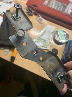

Back to the horn issue...I was finally able to get the screw out of the horn bracket, thanks to the torch idea. I found a couple of random screws that actually fit in the holes on the bracket (looks like they are from IKEA) but they fit in the bracket pretty tightly and they are too narrow for any of the holes on the frame. For now, I used some washers and attached both horns to the same hole but with that placement, I can't get the fender protector back in and I'm also wondering if the second horn is too close to where the tire will turn in. I will carefully test it out once I get the alternator and battery hooked back in. I am thinking I might need to just have someone weld the bracket back in eventually.

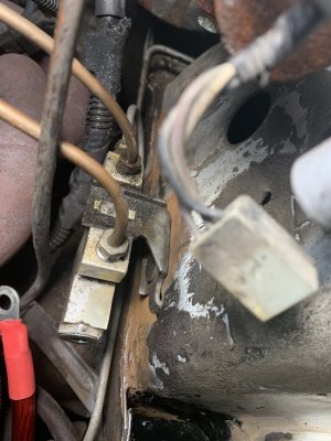

So on another forum, someone pointed out that my brake lines look like they might be copper. My car has a rear disc brake conversion but it looks like whoever did it kept the factory master cylinder and made custom lines coming from that MC.
A few folks have chimed in that copper lines are not good and that I should try to address this. Initially I was looking at purchasing the 1993 Cobra Master Cylinder, which appears to be somewhat of an upgrade, and can fit on 87-93 GT Mustangs without major modifications. The problem I'm anticipating though, is the Maximum Motorsports master cylinder installation kit doesn't appear to include the front port brake line, which I obviously need to replace too. I'm not seeing any front port lines available on MM or LMR.
I also looked at the 94-95 Cobra MC on MM and it looks like their installation kit does include a complete line kit. Anyone have thoughts on the 94-95 Cobra MC for a mostly stock 1988 GT?

The 94-95 Cobra MC, (actually, I believe it is 94-04) is for the 13" Cobra front brakes. The bore size is different. I had to install the cobra mc. (was included with the cobra front brake kit).
Also, the rear brakes will have too much power. Highly recommend installing a bias adjuster. Easy to install at the right side hood hinge, there is a brake line coupler there that the adjuster replaces.
And for sure change those copper lines.

I managed to finally get the POR-15 kit applied to the firewall areas where the hood hinge cups go. I also applied it to the shock tower behind the factory proportioning valve.
If those are Cupronickel (and by the gold-ish colour in the photo, I believe they are), the Burst-pressure is higher than steel, and far more corrosion-resistant to boot.
I used to use steel exclusively, until I actually bent-up and flared a set of CuNi lines, about 3 years ago.....
