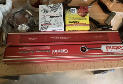

These arrived this week too and fingers crossed that the Koni parts arrive soon. It would be nice to get the brakes sorted, install all new shocks and struts and drive the car some.

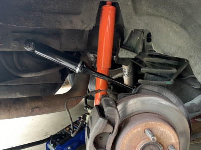

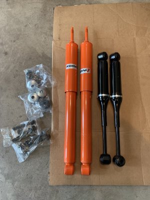

Suspension upgrades continue....this past weekend I finished up the sway bar end links on the front and installed Koni rear shocks and Gabriel (OEM-ish) quad shocks. Love the improved feel. Car would definitely benefit from some new wheels and tires though. Hopefully coming in the not too distant future.
Rear before:
Rear after:
Latest video documenting the process with some other updates

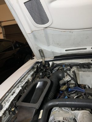

Latest update on the Fox Body....I recently installed a Cervini's Ram-Air kit to go with the Cervini's Ram-Air hood (that was on the car when I bought it). It was a bit of a messy process and in retrospect, there are things I could have done smarter/differently, but it seems to be functioning as intended.
I made a somewhat detailed video of the installation process, since I hadn't found a tutorial/instructional video on this.

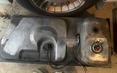

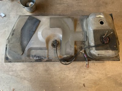

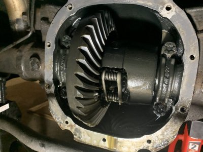

Some recent updates - I discovered a small fuel leak the last time I filled up the tank on the Fox Body. I recently dropped the tank and checked the fuel pump, replaced a few parts (filler neck grommet, vapor valve seal, filler pipe to trunk floor seal, filler neck to housing gasket, new tank pads).
Here's how the tank looked when I dropped it:
And after a little bit of cleaning and removal of the old pads:
I didn't get a pic of it with the new pads and a bit more cleaning. While I had the fuel tank out, I went ahead and flushed the differential fluid. I read from multiple accounts how bad the diff fluid smells but I was still pretty surprised. That stuff is nasty.
I documented these processes in my latest video:

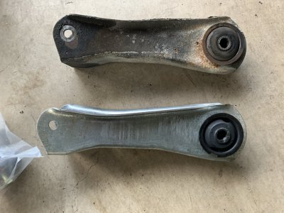

Latest video is up, documenting the installation of the OEM-style upper control arms and getting the fuel tank re-installed.
My latest install, over this past weekend, was the lower control arms...which took a lot longer than I originally anticipated. Video on that coming soon.

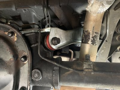

I just finished editing and uploading my video on the lower control arm installation process, which took me the better part of last weekend. My facial expression in the thumbnail photo reflects my naive optimism prior to the installation process.
I've now replaced front lower control arms on my 2014 Mustang, rear LCA relocation brackets on the 2014, rear lower control arms on the Fox, and upper control arms on the Fox. The rear LCAs on the Fox were definitely the worst installation to date. If I ever have to replace the front control arms, I seriously might consider paying someone else to do it, lol.
