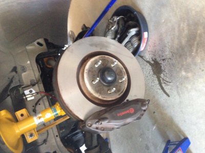

Got the brembos, vorshlag lines, and carbotech pads, and rbf 600 fluid on the car yesterday with the help of Csamsh. Can't wait to get these pads bedded in. Big thanks to Mark for the assistance. And the chance to fart in his driver seat! Lol

Is it hard to put the SS lines on? I want to replace mine, but was thinking I should let a shop do it.
white86hatch
Mar 18, 2013
182
Not at all. The copper washers are a little annoying when trying to remove them from the banjo bolts before you swap to the new lines but overall it's not a hard job.
