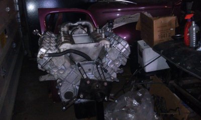

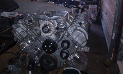

Couple of questions. Why didnt my valve cover gaskets fit? There were 2 little half moons on each of em. Cut them off and they seemed to work. Anyone know if they ever changed the valve cover design 05-10? Im assuming no since aftermarket covers say 05-10. We shall see how that pans out when i start it up.
Next question, im almost at the point of putting the supercharger head unit on. Can i reuse that gasket on the intake manifold (top of manifold to blower)? Or do I replace it?

ah yes, the pics
