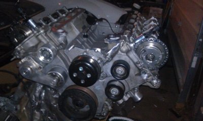

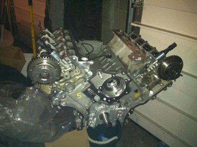

Gonna get whiplash this is coming so fast.
chains on. (cool shot of my it looks messier than it is garage)
tensioners and guides on
front cover laid on. didnt have the right rtv so i have to wait till 2nite to finish that.

it was such a bear figuring out which bolts go where on the timing cover. the shop manual gives you bolt dimensions with numbers for the torque sequence. i had to measure and categorize them by number (position).

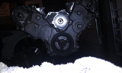

Crank pulley on. Put some rtv on the woodruff key to seal any oil weeping. Crankshaft seal was installed on the timing cover before installing on the motor.
Last nite (no pics) I put on the fr500s oil line/radiator hose thing that replaces the part that the original oil filter goes. Going to do the remote oil filter. Also I put on the motor mount pedistals.
