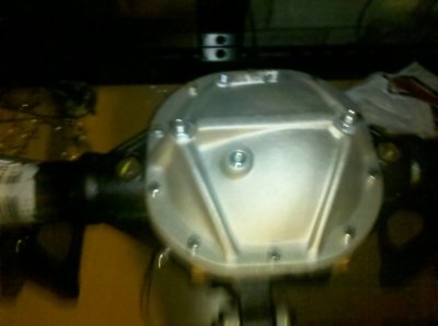

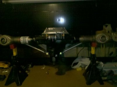

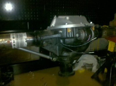

Hey, so look what came!
Thank you Steve Poe. For what its worth to anyone else looking, this is my second transaction with Steve. Hes an excellent seller and a VERY knowledgable guy. The work on the axle is superb.
What is in it?
Its a new takeoff 8.8
LPR Rear cover/girdle
Those support bars are UPR I think
FRPP 3.73's
Auburn ECTED diff
Welded axle tubes
This thing should be able to take a bullet or 2.
What is in it?
FRPP 3.73's
Auburn ECTED diff
Welded axle tubes
Kevin,
Man things are looking good Buddy.
What is in it?
FRPP 3.73's
Auburn ECTED diff
Welded axle tubes
Nice...Steve Poe is a good guy to do business with. I have one of his longblock in my car now. Guy builds these cars from bare shells.....You should see his garage. :beerdrink:
