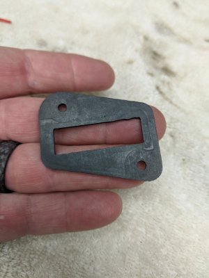

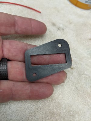

This might prove to be the issue. MAF sensor mounting surface on the JLT intake isn't even close to flat, and it looks like this has been leaking. Think I might put the stock airbox back on and do a revised tune, or figure out a better way to seal this.

Forgot to update this thread:
The problem turned out to be the fit between the MAF sensor and the mounting surface of the JLT intake. There was a significant air leak between the two. I took the JLT intake off and put the stock intake on, Lito gave me a revised tune, and it runs perfectly. I've put about 400 miles on it since I put the stock airbox back on, and no problems.
Now to figure out how to fix the MAF pad on the JLT. There are threaded inserts in the plastic that sit up higher than the sealing surface, making it impossible for the MAF sensor to sit flat and seal against its mounting pad on the air duct. To me it looks like a factory/manufacturing defect, and it's probably too late to get a refund or exchange, but I'll check on it.
