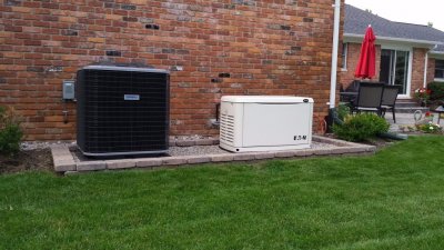

I built a 4x6 treated wood frame, secured it at ground level...filled it with pea gravel, trimmed it with paver blocks and that’s where the generator sits on the fiberglass pad that comes with the unit. Didn’t want a concrete pad for the area it is located. I have my ac wired out so it will never kick on when the generator is running - there is a set of dry contacts in the ATS to accomplish this. I have a 2400sf ranch, conventional gas forced heat and I’m running a 11kw and it’s perfect size. No real big electrical loads. Don’t undersize yourself!
