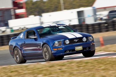

Well its been 14 months since my first event. 4 events later I moved to group 2. Now im at 7 events and am progressing to move to group 3. (hopefully summer of 2019). Learned quite a bit and still going..I've met a lot of great people at Nasa(my primary org) and HOD as well.Everyone was were very helpful. I have done a lot of reading but not a lot of posting here and would like thank all of you for your advise and guidance last year in getting me started.
Yep, Im Addicted now.So I've decided to set my goals to make it to TT class if possible.
The car is holding up well and will be upgrading to the Brembo BBK for the 2019 season as predicted Already installed cooling ducts to keep the factory ones cooler..
I did change over to R comps 2 events ago and was amazed at the difference it made. Staying on the street tires for as long as I did was a great move. Glad I listened because I was getting frustrated with car in the beginning not realizing it was ME and my driving technique and NOT the car at the time...The transition was a lot easier now that I waited.
I have some questions on safety upgrades I will post separately since im going much faster now.....Best lap at NJMP Thunderbolt was 01:38.20 so far that doesn't seem that bad for my experience level
Thanks again and Happy Holidays.
