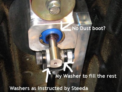

1. In the first attachement, I show the following issues:
a. washers used to make up for difference in width between the GT500 shift lever and Steeda's (for $300+ would it have killed you to machine the right part rather than re-use the wrong one?)
b. Steeda suggests/provides 2 washers (on the left) - I needed a third..
c. Note the size of the washers they provide - the importance of that will be demonstrated later...
d. no dust boot? Nice lubed up parts just sitting there waiting to soak up the road?

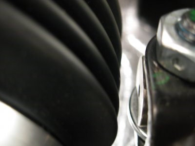

2. The second attachment shows the bigger of the problems...
The PH DS leave no room for error and Steeda soaked it up with big honk'n washers... Note my nice tidy washer takes up no more room than the linkage itself?
So add this to my prior failure to ignore Steeda's tech support...
There is the issue of the DS just being very LARGE - I'll have to do some math and talk to PH about this - it may be that a single mm more than the stock GT500 is too much on this setup...
p.s. my "nice tidy"TM washer was ground from a smaller ID washer... I guess I have to make 2 more...

That blue piece is the dust boot. They have been using it for 2 1/2 years with no complaints that I'm aware of.
But how many people have gone under there and checked on that to see how much road dirt and wear on that part? Probable no one. That is still a poor design. My Pro 5.0 has a nice clear boot to cover that area from water and what else the road will have to offer greas.
You are likely correct - that part is almost certainly labled "dust boot" and it is better off with it than without it...
But generally a dust boot works best if the grease cant get out... If it can get out, then dirt/water can get in (not to mention you can see sensitive parts if you look carefully through the dust boot)...
I suspect it will last long enough in this configuration that the complaints would take some time to come in - or the part/car would be replaced/changed prior to it mattering...
That said - Ford put a boot on there, I would/will put a boot on there, seems like a silly thing to cut a corner on.... I don't like dirt in my moving parts regardless of whether it is fatal or not...
