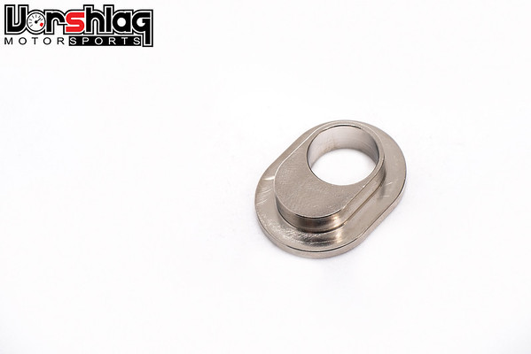

My Hanchey/JRi struts also have that hole slotted.....never a problem. The Penske struts are the same way. I wouldn't sweat that slotted hole.

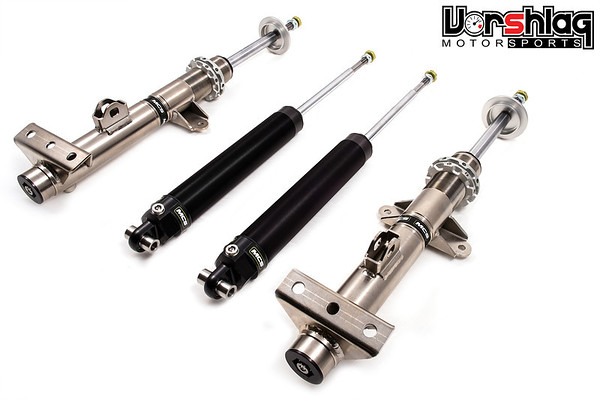

For me, if the Koni's aren't going to make you happy, and KW's aren't something you want.. it will be MCS. They don't break like others have. I've been extremely happy with the base valving, not had to send them back. And see tangible change in each setting.
Anyway, if you are into something higher end, MCS has dampers that are single, non-remote double, remote doubles, or remote triples and prices for singles start right around what KW Variant 3's are (but MCS come without springs or spanners at that price).

The Vorshlag MCS TT1 coilover setup (ASTs are no longer on their site) gets you just the dampers. You have to add springs and camber/caster plates to get an equivalent kit. The dampers alone are $2650. After adding the camber/caster plates, springs, and modified shock mounts ($20), you're looking at another $850, so that setup will set you back a total of $3400.

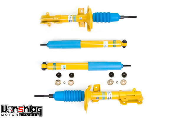

Vorshlag recommends the bilsteins because they are monotube, and the koni's or GC are twin tube. How much will this really affect my handling?
Monotube vs. Twin Tube is as much a religious argument as Whiteline versus Fays2.
Well, for a Stock classed autocross car maybe that holds, but for anyone dialing up the performance/grip/power level outside of that very limited mod autocross class, I think the monotube wins, hands down. Yes, it costs more than a twin tube - nobody will deny the cost difference. But the performance difference is just as big as the price difference, when comparing feature for feature, in my experience. And in virtually all levels of competition, you see monotubes instead of twin tubes, since about the 1990s and on.While I philosophically like a monotube from an engineering point of view (larger piston, better resolution, etc), in the price point that you are talking, I prefer the Koni yellow because of the adjustability. The Bilstein is a fine shock, but given a theoretically superior nonadjustable versus a theoretically inferior adjustable, I'll take the opportunity to adjust.

But you would have to be insane to buy their bilstein setup over ground controls when what you are looking for is the best handling $1500 can buy. It is not worth the sacrifice in spring rate, valving, and adjustability that you give up just so you can say "monotube" when people ask what shocks you have.
Well... I think you might be comparing apples and oranges here, just a little. Twin tube coilovers start at $1600 (the GCs mentioned - I don't know the bare shock-only breakdown), and good monotube single adjustables start at $2200 (the formerly imported AST 4150). Right now there's a gap in the market with the ASTs being gone, so you have to jump up to the $2650 MCS (really $2850 with rear ride height adjusters). That's a big gap, we know...Good monotube dampers start at over $2000. Good twin tubes start at $750.

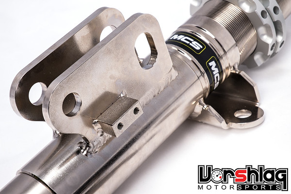

I contemplated getting the MCS Coilovers for a few minutes also but eventually couldn't get past their use of an oblong front strut mounting hole in the top position. IMO it seems like an open door for issues with the strut slipping around and migrating out of proper position over time, especially under heavy side loads from an already heavy car.
