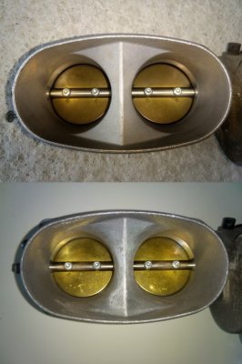

BBK throttle bodies are also hit and miss. If you still get idle surging with a new tune from Lito, port the stock throttle body and swap it back in. This is what mine looks like. The top picture is stock and the bottom one ported.
