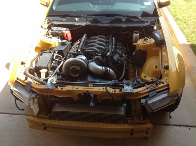

My car is officially part of the 2200 class.

Nice! Correct me of I'm wrong but I remember reading that u can run the bov without the filter? What are the pros and cons? Car is my dd btw.

People are running without the filter, but it was designed for use with one so I will keep the filter on mine.

With or without filter. Either way will do. It won't hurt it without, and I even advise changing the valve to a bigger one as I think the kit is undervalved from the start. They skimped on it to save money and make the kit cheaper.

What would you recommend switching to?

I highly recommend the TiAL Q valve with the supercharger spring. The valve that comes in the kit is too small and flutters. Fluttering may sound cool to some, but with each flutter is pressure on the turbine in the blower, which is bad joojoo.

Stock Paxton kit valve, flutter
Replaced it with a TiAL Q valve, no flutter, plus badassery points
More info in my build thread, page 38. Click my sig link
