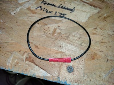

Most don't realize this, but a butt connector actually requires FOUR total crimps. You need to crimp the actual wires in the center and crimp over the insulation at the ends. The second set of crimps prevents stresses on the connection.
I can take a picture if my description sucked.

OK, you see how there are 4 crimps? The middle two crimp the bare copper conductors and the metal part of the connector to create electrical continuity. The outer 2 are on the edges of the connector where there is no metal. Those plastic edges are crimped onto the insulated part of the wire. Those outer crimps prevents any strain forces from reaching the actual connection.
You should then wrap this connection in heat shrink or at least electrical tape.
Yes, I just ran down to the garage and made this just for this post.
I prefer the heat shrink connectors. They don't come apart.
