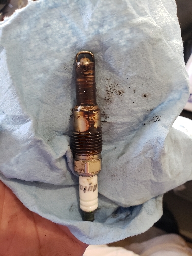

Alright, it's been a few days but I am happy to say that the car is running and drivable (enough to tune atleast).
I cleaned all the plugs and connectors with QD cleaner. Proceeded with pinout tests. All pins checked good. Checked continutiy on all the pcm power relay wires and all the wiring for the PATS system. Everything checked out.
After talking with the tuner and finding the revision from Kenne Bell, I ordered a set of standard iridium plugs to swap out in place of the step colder autolites. Car fired right up without a hitch. No codes.
I'm thinking cleaning and doing the pinout tests cleaned up the contacts real nice to make complete connections. As for the no start, definitely caused by the plugs.
Attached are pictures of two of the plugs I pulled. About half the plugs looked like this.

Yack... Are those new? Look like they've been in there for a couple of years.
