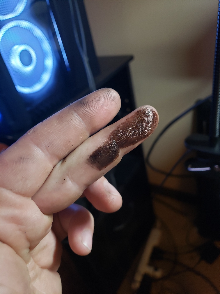

Well I was double checking some things today. Pulled the blower off and spun the rotors. Odd smell coming off. Then I stuck my finger down inside the opening for the bypass valve on the discharge manifold and found this.
Edit: smells like oil. Blower is second hand. I checked my oil and my coolant. No mixing.

Some oily residue is ok. Have you checked any plugs? If it is oil where its not supposed to be, then the plugs will be soaked in OIL. But you would have had james bond smoke while it was idling if it was an oil issue.

Some oily residue is ok. Have you checked any plugs? If it is oil, then the plugs will be soaked in OIL. But you would have had james bond smoke while it was idling if it was an oil issue.
Yeah, didn't have that.

Then dont worry about that oil residue. Fix the electrical issue.

If the previous owner wasn't running a catch can you might get oily residue like that. I had a decent oil slick inside my supercharger and intake manifold before using one. It was lighter in color though.
They didnt appear to be. I installed a JLT catch can with the KB on my car.

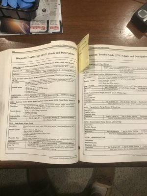

I have the Workshop Manuals Vol 1,2 and the Wiring Diagrams. This one's different. Here's the manual I'm talking about; true step-by-step troubleshooting guidance... just email me for the PCM 0906 troubleshooting section.

The PCMRC's are on pg 5-8/9; the pg shows different types of power relays and the pin connections. ID which type your car has to test the pinouts. Attached is the layout for 170 pin PCM connections.
