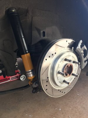

Dino from what I've read changing gears requires a new tune to ajust the speedometer...correct ? as for the LCAs my whole suspension as been upgraded and replaced it was all shot when i got the car. I've got he GT500 Front LCAs along with the Ford Performance Rear LCAs Koni Yellow Shocks & Struts.GT500 Strut mounts Ford performance swaybars fron and rear and the ford preformance lowering springs. All the sway bar limks and tierod inter & outer have been replaced along withthe front swaybar links as well. I also have replaced the driveshiaft adding the DDS aluminum one piece. IMG_1939.JPG

Dino from what I've read changing gears requires a new tune to ajust the speedometer...correct ? as for the LCAs my whole suspension as been upgraded and replaced it was all shot when i got the car. I've got he GT500 Front LCAs along with the Ford Performance Rear LCAs Koni Yellow Shocks & Struts.GT500 Strut mounts Ford performance swaybars fron and rear and the ford preformance lowering springs. All the sway bar limks and tierod inter & outer have been replaced along withthe front swaybar links as well. I also have replaced the driveshiaft adding the DDS aluminum one piece. View attachment 77385
Sounds like you're already sorted in that department.
New gears are a simple adjustment on the handheld if those parameters are unlocked.
What he said. An unlocked SCT handheld tuner allows you to adjust for any change in axle gear ratio, and also allows adjustment of revolutions per mile if you change the tire size.
