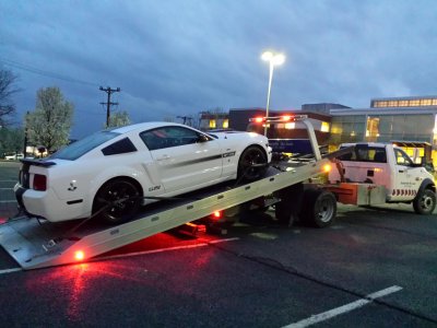

I have an 2008 Mustang GT with an on3 Turbo. It was putting down 480 at the rear wheels. Was driving through town and blew a rod through my block. Need some ideas for a 4.6 short block that can handle the turbo without breaking the bank. I'm hoping to put my intake, heads and turbo on the new block with maybe a 75hp wet NOS system. I will be changing the clutch to handle the power. I already have a Richmond rear end.
