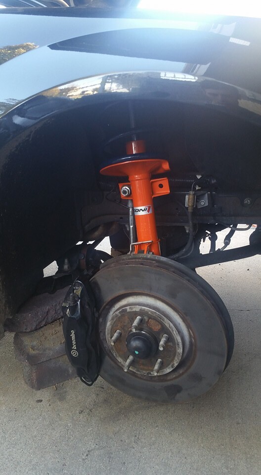

Koni Orange Shocks and struts w/ Steeda Sport Springs. (Eliminated factory wheel hop)

You're not going to like the Street comps on a gt500. Dismount the MPSS, sell the CS70s, mount MPSS on new wheels. Pin the axle tubes, don't weld them. VMP heat exchanger, not afco. Fixed all your mistakes (won't get into the bags :) )
Kput
Jan 19, 2014
80
Good advice, I haven't 100% decided on brands and such yet.
Why do you say mpss over the street comps? I want 19's so I'll still wind up selling this set.
Also why pinned axle tubes over welded?

Installed my BC Racing rear springs and perch today. Pulled the bump stops as well. Haven't gone for a test ride quite yet, but I'm happy with the ride height... can't wait until I'm bagged and can get rid of this static nonsense.
Before, Koni Orange w/ Steeda Sport Springs
Spring comparison, as you can see I don't have the rear dropped as low as possible, as I don't want to be smacking the bumpstop rest every time I hit a bump or accelerate. I may wind up having to go a bit higher, we will see.
And here we go:
