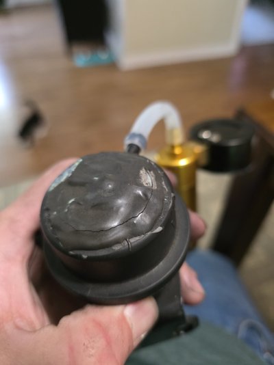

I found my problem. When I first installed the supercharger, I had read that some recommended modifying the bypass valve actuator since I had cams (due to low vacuum). I drilled a hole in the end of the actuator and removed the spring, then jb welded it back together. After test driving it, I quickly found that modifying the actuator was not necessary for my car at all. So I took the actuator back off and put the spring back in and then resealed it with jb weld. The car operated in this state for 4 years or so, until recently the boost was down from 10-11 to about 5-7. Turns out my jb weld job failed. See attached picture. I'll order a replacement.
