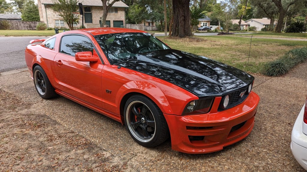

I recently bought a 2005 GT and it has quite a few mods done to it.
Cam swap, rear-end, Hurst speed shifter, headers and full exhaust.
I was hoping to grab a tuner and update the settings for the rear-end so I can calibrate the speedometer.
The problem is I don't have the stock tune and I'm not sure if the new programmers are capable of downloading the modified tune so I can back it up in case something was to go awry. Or heck, even if they're capable of downloading a tune that doesn't match the device.
It's definitely not worth bricking the car to fix the speedometer.
What are my options?

With the cam setup, CAI, headers, I presume it's going to run extremely lean and\or set off the knock sensors.
I was hoping maybe I could find the previous owner on one of these forums.
If someone recognizes the car, please let me know.
The cams aren't overly aggressive, but it definitely has some lope to it. (don't mind the exhaust rattle, I fixed that already)
