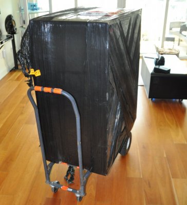

I ordered this kit about 2 weeks ago and it showed up today, they packed it super well, it was shipped via freight:
I chose this kit as it seemed the most complete and the most straight forward install as I plan to install it myself.

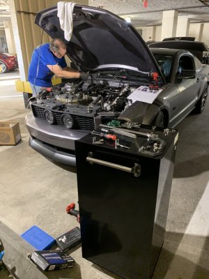

OK so install has started, I I got to page 21 (of 33) so far I would say its going pretty good. I am happy to report that all the spark plugs came out just fine this time. I got to the part in the instructions where its time to set the SC in place. I will get to that in the morning.
So here is a photo of the install so far, yes I live in a Condo and I am installing in my Condo parking spot.

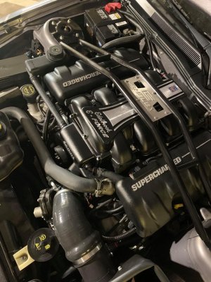

99% Done:
I have to go get some Radiator Fluid (for the air to water intercooler and the radiator), wait on the tune from Edlebrock, and order all new inner fender push pins and screws (those things are just kinds buggered up.
I did not lose any sockets or bits (amazing).
I only broke one small bolt - which I will order also.
Kit was pretty ease to install, my only complaint would be they did not tell you you needed a 15/16 socket to install the provided alternator nut (for the new pulley).
Side note - the fuel injectors install so ease compared to my MINI Cooper(s).SuperCharger Installed (1).jpg SuperCharger Installed (2).jpg SuperCharger Installed (3).jpg SuperCharger Installed (4).jpg SuperCharger Installed (5).jpg

I love how the engine covers make that install look so clean, nearly stock.
Only hate the intake tube. Those shiny things looks like a big slug is trying to escape through the top of the engine bay.
Me too, that did influence my dissension to buy this kit, that and the installation instructions were extremely thorough, and thanx for your comment on it.
I did not like the intake either, but I no longer had the factory intake - that intake is the part of the Stage 2 kit from Edlebrock, funny thing is its actually make by Airaid, I wish it was a hard tub like the Airaid I took off the car.
