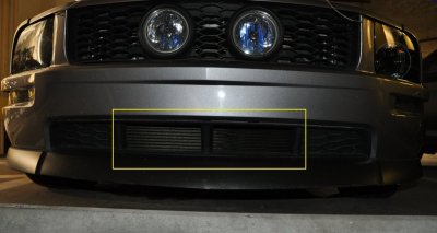

Looks like a very nice install, very clean. Where does the intercooler mount?
Its super stealth black in color and goes in the factory opening, bolting to the back of the metal bumper.
