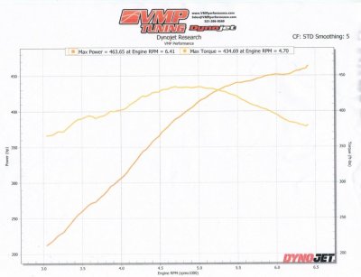

FOLLOW UP to my problems with VMP:
I was contacted about an hour or two after the sales guy asked me what I wanted done (having told him take out what you did and put it back to the Edelbrock provided tune). I was contacted by Chuck the head of sales, he wanted to hear the entire story and fully accepted that they "dropped the ball" he told me where the problem was and did not try and make an excuse for them making a mistake. I can understand mistake happen and his accepting the responsibility actually means a lot to me.
He went over what was done, and we came to an agreement, so they finished tuning the car, and we agreed that I would pay the original quote for Dyno time and tune (650$). I am agreeable to this as it is what I was quoted originally (yes mistakes were made but life is not perfect). I dont really care about the 10 days time, its not a daily driver, and he agreed that they should have communicated.
So in the end I am OK with the outcome and I am happy with management at VMP for stepping up and rectifying the problems, accepting responsibility and doing something to make it right.
I was told that the car put out 463 to the wheels(which is great as my requested was about 450), I was not able to get the car today (and wont be able to now till maybe Thursday). But I will post a dyno sheet if I can and give a review of the finished tune soon.

I picked up the car today, Chuck (head of sales) was there to talk to me and try to smooth over the screw up. note he did not really need to do this it was already done by them on the phone before. I was informed that the sales guy I was working with was 'no longer with the comapny', at first I felt bad, but I was informed that he was just not a good fit for the company, and they had some issues before. So maybe my experience was just bad luck.
Moving on, car starts and drives like stock if you want it to - which is good, the throttle is very linear (I had an SCT tune in it before and I hated how they had 75% of the throttle in the first 1/2 of the travel).
Shift are nice and crisp - this was a problem with the Edelbrock boxed tune that came with stage 2 (way soft).
I only drove it home (about 40 miles on the highway) and to lunch, but the couple times I gave it the sauce it felt good. I did drive it a little today when it was cold and it has a stumble at low throttle when cold - I will call them about this.Mustang Dyno sheet after VMP Tune with SC.jpg

Damn man, that thing is looking real healthy!
Congrats on getting everything sorted and having a well tuned ride!
400rwtq from 4k to 6k jeeeez, that's a kick in the pants I bet it's a beast!
