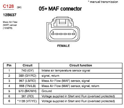

Is is ok if I take the connector that plugs into the MAF sensor and cut and extend the wires? The wire is too short and will not make it into my MAF sensor, this is the last thing I need to get my car running

Just make sure you do it right, with soldered connections, shrink wrap to keep water out, etc. And keep those wires away from rotating parts... ask me how I know. :)

Many blower kits have you splice the maf wires to make them longer.
I've never had any issues extended maf wires.
As stated, just make sure you solder connections and use heat-shrink and seal the connections to keep them sealed and clean, and secured out of the way of moving parts.
Splice one wire at a time to make sure you don't cross any wires, if that helps!

Don't most s/c kits require an extension of the MAF wiring? Mine did.. Very easy. Take your time and solder it neatly, heat shrink it, and wrap it up with 3M electrical tape. Done! There's no fucking reason to add a MAFIA for this...

He's talking about physically making the harness plug longer. No need for a MAFia.
Since the OEM MAF reads both air intake, AND intake temps, the Kenne Bell kits require you to cut the OEM MAF plug off the harness, and separate the IAT wiring, and the MAF wiring, in order to put the IAT sensor in the manifold, and the MAF behind the passengers headlight, where the filter is housed.
