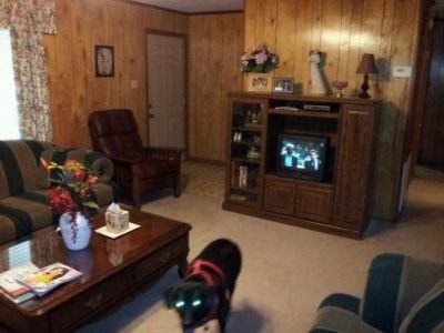

My Dad bought a 1200' temp building and gutted it and built back the way he wanted it. At one point you could see everywhere in the house, he ripped out all the sheet rock, moved the walls to shape interior the way he wanted it. THe crazy thing about it was, he worked for he phone company. He did a knowcked out job. I will find some pics and post them.....you won't believe it.
He passed away in '05 and I really miss him. I have 3 younger sisters, talking about a estrogen high environment....lol.
