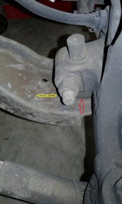

Jacked her up this weekend. I grabbed the tire at the top and bottom and there is no play at all. But when I grab on front and back, there is a little bit of movement. Then I discovered what is in the pic. The object the red arrow is pointing to moves about 1/8-1/4 inches side to side as the yellow arrows indicate. Everything else appears to be tight as a tick. Is the movement normal? If not (and I assume it is not) what is this and how hard to replace it?

Did you use your hands or a pry bar under the tire to check for play? Regardless it looks like you have a bad ball joint. Ive never replaced one on one of these cars but its not too hard. You might want to consider replacing the whole lower control arm for ease of install. You can press the ball joints in/out but you risk elongating the hole.

A ball joint wouldn't care which direction you turn as far as making noise when it's bad. I agree the end play isn't good but this is not your noise.

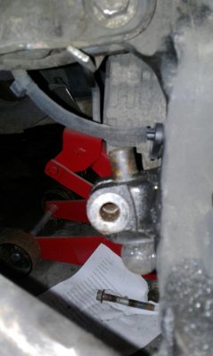

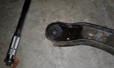

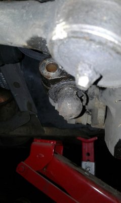

Problem is solved. No weird vibes, no clunking, no bumping. The 2 hour job turned into a 4.5 hour job due to the fact the ball had come out of the socket. I am guessing that is why it was such a weird thing going on. Then I had to use 2 pickle forks to get the old stem out. Once that was done, reassembly was pretty simple. I need an alignment though.

WOW you are lucky that didn't come apart driving! How many miles?
Alignment should be close as long as you didn't touch the tie rod (toe in) adjustment. You can use a long string to check toe. Heck, I used a level app to set camber after I did CC plates.
