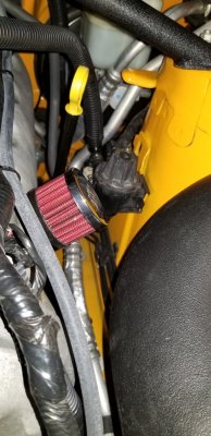

20190420_200236.jpg 20190420_200226.jpg Just curious. My oil breathers are vastly different in appearance after 2,800 miles.
Is this unusual, or just the nature of the beast?
Car has 57,000 miles and has had the Paxton on for 2,800 miles. Passenger side oil soaked, driver side clean and dry.

View attachment 69457 View attachment 69459 Just curious. My oil breathers are vastly different in appearance after 2,800 miles.

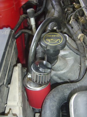

'That's normal when you have a healthy engine with breathers on both valve covers. Just install a breather catch can on the passenger side so it'll collect all the crud and keep your valve cover clean. I made my own:
1 x 220g baking soda tin
1 x Scotch Brite scouring pad placed inside tin
1 x 3/8" valve cover breather filter
2 x 3/8" barbed fittings epoxied to lid of tin
1 x 3/8" vacuum hose
2 x small hose clamps
Like you, I've capped off the intake manifold PCV port and have a valve cover breather on the driver's side, but that renders the breather virtually useless. As 95ragtop said, there's a PCV valve inside the driver's side valve cover and that only opens either if it's connected to the vacuum of the intake manifold, or if there's excessive blowby of combustion gases past the piston rings causing pressurization of the crankcase. If you have the latter, the breather filter will become oil soaked and that's bad news. Otherwise the PCV valve remains closed and the breather filter remains dry. In order to make the driver's side breather filter functional as a breather, you'd need to remove the valve cover and cut away the PCV valve.

There is a one way valve within the valve cover of the driver's side valve cover. This valve only allows air into the motor, not out. To remove it you need to pull off the valve cover and cut into it.
This.
And the passenger side is a small about 5/16 outlet so all the venting is being done on that side so it will push more oil.
The driver side has much larger outlet about 5/8 but you need to remove the valve inside the cover to take advantage of it. Once both banks are vented properly you will push little to no oil into the breather itself. A oil cap breather helps alot as well as it's a huge opening to vent from.
I run 3 like I just mentioned with pcv valve removed and my breathers drip no oil and rarely need cleaned on a built motor pushing 16-18psi.

It'll be fine as long as the passenger side breather doesn't get clogged up.

The difference is whether the positive crankcase ventilation (PCV) valve in the driver's side valve cover (VC) remains active or not depending on the crankcase ventilation set-up.
If you only have a breather filter on the driver's side, there's no vacuum to open the PCV valve so it always remains closed. This means that the crankcase now has to ventilate on the passenger side, and that's why you either need another breather on the passenger side (which gets dirty more quickly), or a catch can breather like I have (which keeps the filter clean).
If you have a catch can on the driver's side VC that's connected to the intake manifold vacuum port, the PCV valve will open under that vacuum and vent oil vapors from the driver's side. In that situation, you cannot run a breather or a catch can breather on the passenger side as it would effectively cause a large vacuum leak with unmetered air entering the intake manifold. You must run either a regular catch can on the passenger side or a straight pipe from the intake elbow to the passenger side VC.
