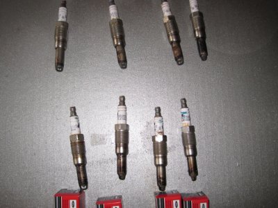

My advice comes from reading many articles on changing these plugs on a 4.6L. First try to loosen the plugs about an 1/8 of a turn. The screeching and cracking noise is the carbon buildup on the shaft of the electrode. This is normal! After all the plugs are loosened, spray a good amount of WD40, or other penetrating oil into the plug hole and allow to seep in overnight.(This will help soften the carbon deposits on the plug.) The next day, use steady firm pressure to unscrew the plug. Sounds awful while you are removing them... but I had no trouble getting them out in one piece. Hope this helps!
Below you can see how the penetrating oil helped clean the plugs by dissolving the carbon off of them before removal...
