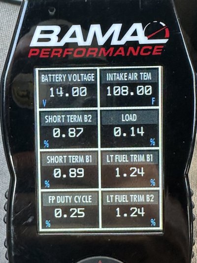

Where else can I look? My SCT (from another car, married) does indeed show fuel trims way out so it is indeed lean on that side.

Surprised I’m not seeing one bank affected. These are both very similar and wrong. Now I may look towards some of the common ones for both banks (MAF, TB, other vacuum leaks etc)
Unless you had a really big, audible leak at the manifold flanges, I wouldn’t expect it to be that skewed.
I would pressure test the intake track starting from the air filter back. The way I did this was putting a rubber glove over the filter inlet (I have a Steeda CAI) then adding some light air pressure via the EVAP port on the manifold. When I did this, the entire intake track, including the CAI was air tight and didn’t lose any air. Worth a shot, cheap and easy.
I am going to ask another clarifying question…stock intake box or cold air intake? MAF scaling being incorrect in the tune would also throw trims very much out of wack.
Edit: re-read your post and saw you have a stock air-box. If the previous owner had a larger CAI that it was tuned for, I wouldn’t expect the see positive fuel trims.

I think I’m seeing the opposite issue here. It’s a Shelby GT, so the “stock” box is the Steeda 90mm, but of course it came tuned for that. I *think* it’s been flashed to stock… so its acting like it’s got a CAI without a tune because it does.
Is this feasible given the skewed LTFT’s? Before I go buy an unlocked tuner (made a WTB post).
IF someone or a dealer flashed this to a “stock GT” then it def needs a tune for the correct Steeda CAI that’s in place.
Sounding feasible? Again I don’t know much on the history of this car, just speculating.
I can try and buy a tuner and flash a canned tune for the Steeda and see, or go buy a stock airbox for a GT and give that a go… just for testing.
I am thinking that’s it.
The Shelby GT has the same 90MM MAF housing as the Steeda, so your MAF transfer function is too low if you are running the stock tune. The stock MAF housing is 80MM.
That would explain why LTFTs are showing 25% richer….the 90MM MAF has about 26.5% more area than the stock 80MM.

That’s my theory too. Again I have zero history on this car but if the EXU was flashed “to stock” the Steeda CAI would be wiped out and explain the massive lean. Unsure why only one bank throws the CEL but the LTFT’s clearly indicate it’s an issue on both sides.
