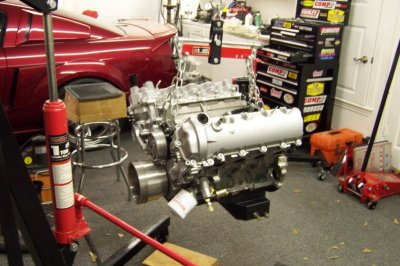

Dont let the transmission scare you i used a cherry picker to remove my engine and transmission the the heads still atached just very carefully
I droped mine in by myself with the headers and all . Everything except the intake and the front plate on my crank support. With a small picker in the garage. I had to use a leveling divice and a jack under the car to catch and lift the trans after it was in the tunnel. If he has 6-8 ft in front of the car and an 8ft ceiling then it is possible.
Ron, here are a couple of pics of what I an talking about. I dont have one of the entire unit on the picker, but you get the idea. I had the bumper, bumper cover, and radiator ect out as well.
Here is the equipment.
Here is what I stuck in the bay. Less the intake and front plate on the crank support.
dam that motor looks sexy
