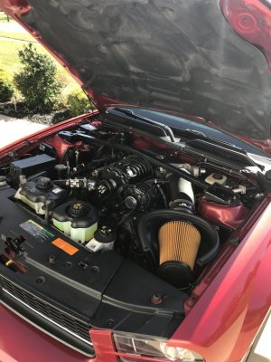

Two things I recommend if you do decide to buy the DOB manifold: 1) Get the insulated option (composite heat barrier). It's an absolute must to keep the IAT's down especially if you're shooting for a 1000 hp. 2) Spring for the anodized option; color? Your choice of course but I went w/black which is what Jason recommends. Looks great and will keep the manifold protected for years to come.
