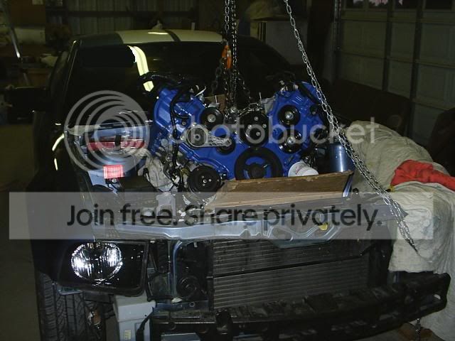

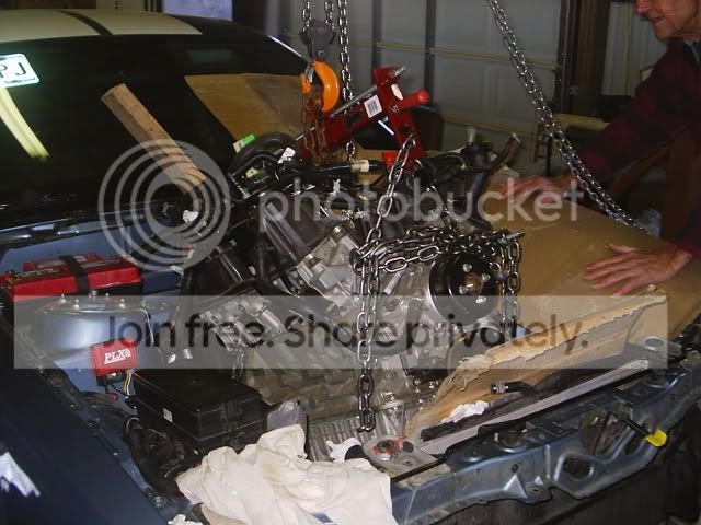

A couple pics:
V8 going in at angle (trans is connected to it); I used a board against the radiator and cardboard on top:
V6 coming out at similar angle:
I bolted chains to the transmission ears and used the leveler to help get more of the angle.
The hoist I used was over 9' tall.
