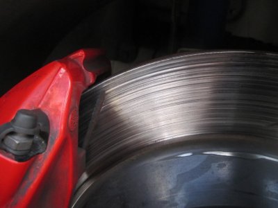

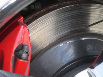

    Do these look like small heat cracks, appears they are? Not great pics .. you may need to zoom in on it..

    Yup, there are a few tiny heat cracks, but that rotor looks like shit. I get new ones just because of all the groves.

    Believe I only have 5 track days on those... :( New one's are on order, trying to make the last track day of the year at BIR Oct 5th....
