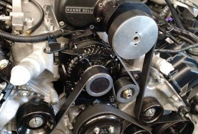

Thats not true. I have a KB and DOB alt. A couple small mods and it fits fine.
Huh. When I talked with DOB, they swore their alternator was incompatible. It's not like they didn't have something to gain by selling it to me.
I got what I got now, i.e. the 200 amp PA Performance. But, I'm curious, what modifications did you have to make in order for the DOB version to fit the KB?

I cut the power bolt down. It was ridiculously long. I cut off the straight out field wire plug and put on 3 individual 90 deg connectors.
I didn't even ask dob why it would not fit. I just bought it assuming that I could make it work. It was pretty easy. Afterwards I showed him pics and asked why he didn't want to sell to KB owners with some extra instructions.
He said "Unfortunately putting modification instructions together is asking for more problems than it is worth selling a few extra units. People like you, they get it done no problem. Unfortunately the majority of people will have issues. And that makes them my issues.
The "hot rodder" is going the way of the Dodo. Most people are "bolt on-ers" now. If it doesn't jump out of the box and put itself on the car the majority of people either won't buy it, or screw it up trying to get it done."
And I have to agree that he is right. This is what I did.
Thanks.
If he had simply explained that modifications to the wire clearance were necessary, I would have purchased from him. His loss.
Ironically, I had tried to make a 215 amp Police Interceptor alternator work, and I had to modify the power bolt - there is a thread or two on here about guys making that work. But, it physically wouldn't fit with the KB manifold.
I would have assumed, based on DOB's strong position that their alternator wouldn't work, that it was about the size of the unit and not just wires.
