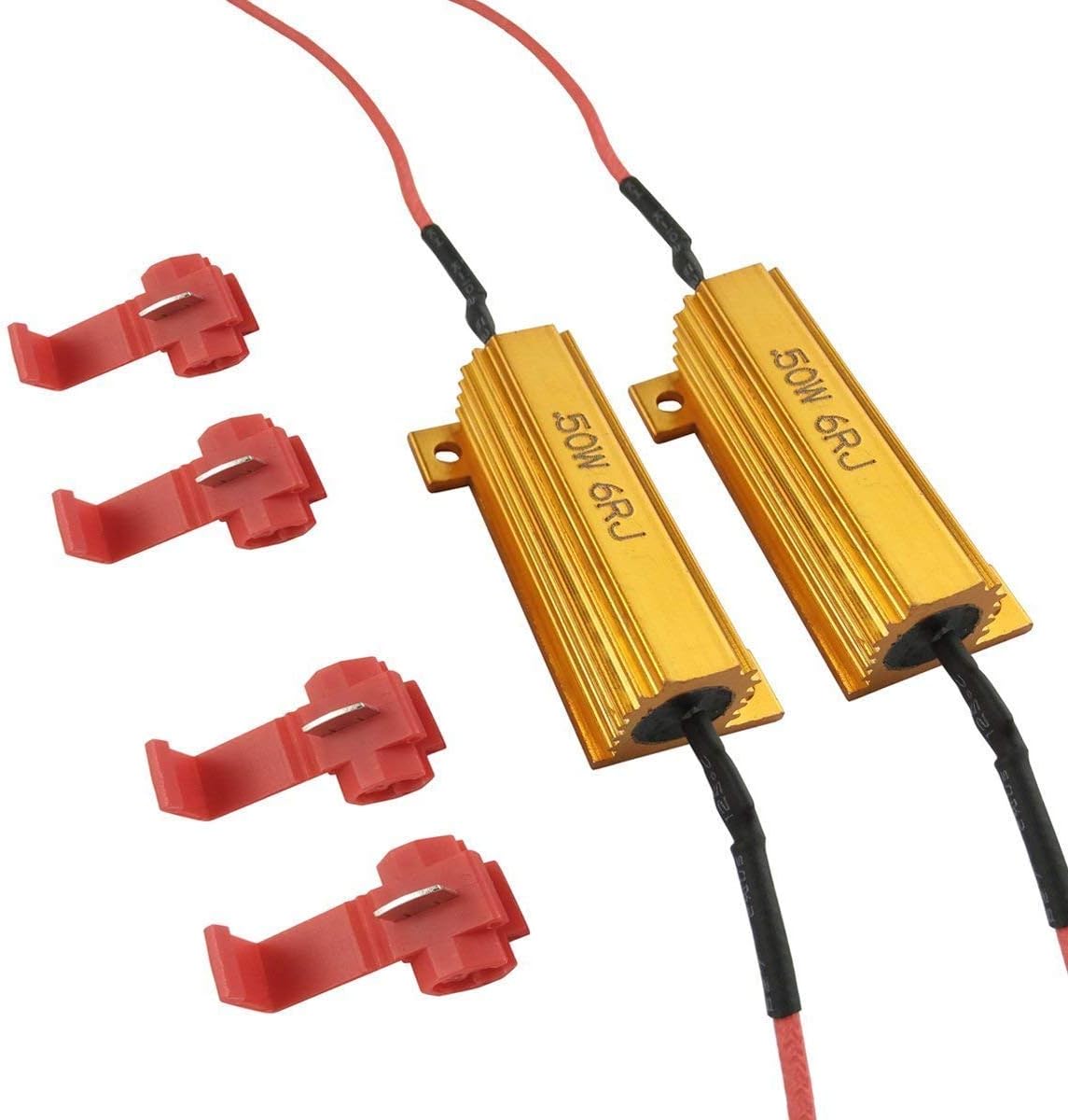

I went the resistor route. Mainly because of hyperflash of turn signals. IIRC, you do not have to match the incandescent bulb's draw. Just enough resistance to trick the SJB. I forget what ohm resistors I used, but they are very small in size, can easily be added at the connector. They do get hot to the touch, but no other issues. Had that setup for years. I have a few resistors left somewhere, if I can find them, I will post the ohms.

Properly sized the resistors should not get hot in this application. By sizing I mean wattage rating and required resistance, not simply resistance. A 1/4 or 1/2 watt resistor will likely not suffice safely.
Using your meter measure the resistance across the reverse lamp bulb. This is your total resistance you are targeting. Then take a resistance reading across the LED lamp. You will need to observe polarity when doing this so the LED forward biases. Then subtract that resistance from the resistance of the bulb and you know the resistor ohm rating you are seeking. Next take the ohm value of the bulb and use the following formula to determine total wattage E^2/R or Voltage squared divided by resistance.
Voltage would be that which is measured with the reverse lights on. (likely 12-13.8vdc)
Finally you will also calculate the wattage (unless it is known) of the LED in the same manner. Subtract the wattage value from the total wattage calculated for the tungsten bulb. This will give you the wattage rating you need for the resistor used. Now you have a properly sized resistor that will properly dissipate the heat without burning up or getting hot to the touch.
Installing a larger than needed wattage value resistor is fine. it is only when using too small a resistor that there is an issue. Its the same as trying to run 22 gauge wire to pull 10 amps of current across it. It will turn into a heating coil.

Just snap on one of these between the + and - wires leading to the backup lights. It is quick and easy.
https://www.amazon.com/iBrightstar-50W-6ohm-Load-Resistors/dp/B07HF47RV9/ref=sr_1_4?crid=48DTXS2WL814&keywords=resistors+for+led+lights&qid=1654818511&sprefix=resistors+f,aps,92&sr=8-4

This.....though I would recommend soldering the wires vice using those clips which I haven't had much luck using. Sometime they work but ones I've used typically develop issues later on.
I have not had any problems with those connectors. I wrap them in electrical tape and they are good to go. You do need to use the correct clips for the gauge wire you are spicing and I use a pliers to "set" the metal splicer completely before I close them. I solder some connections but these are ideal for this application.
https://www.electricalbasics.com/blog/Use-Tap-Splicers-to-Connect-Electrical-Wires
