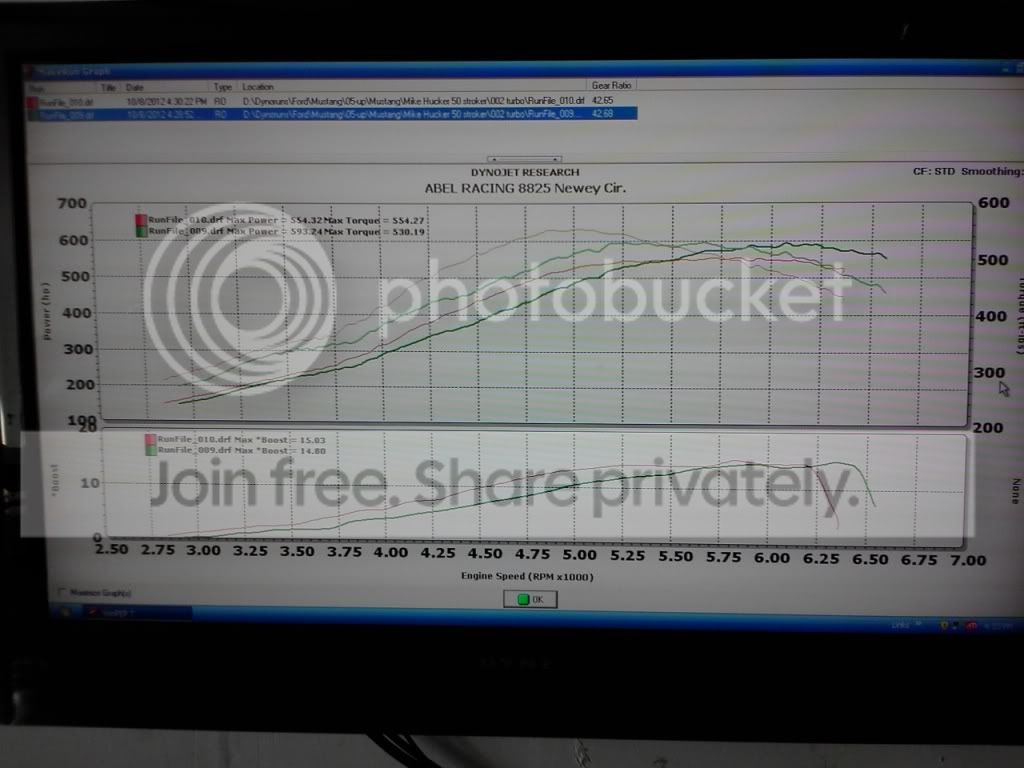

I did, I mean the WG itself. The 2 pipes that hold it together.
That would be an exhaust leak only as those are exhaust pipes. Any vacuum leak would have to be post TB.
The link didn't work for me Fuel
I editted the above post.
I thought I told you about hooking the line to the wg off the compressor housing Mikey? If you did that, then that can't be a vacuum leak.
^^ That sounds perfectly fine to me. I was texting with Mikeyfitz when he was installing his kit, that is what I was referrring to.
FWIW, I had an exhaust leak on my car at the exhaust manifold running 8lbs and still made full boost by 3000-3100 rpm. If this is an exhaust leak it would be enough to hear easily I think.
