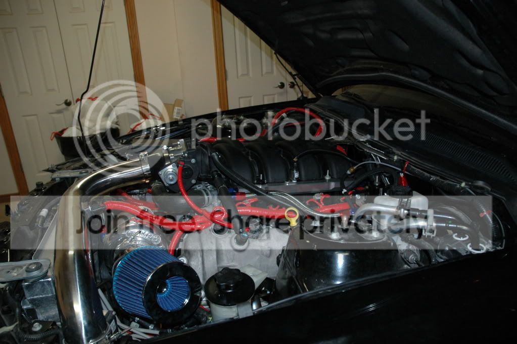

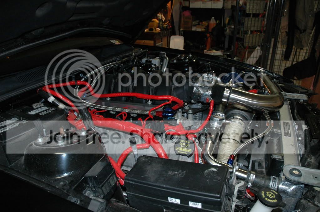

Here are a few pictures of the product. Need to trailer it up to Oklahoma City to get it tuned.
Oh yeah, don't rag on my coolant line from the bock to the radiatior. I deleted the reservoir and that is just temporary (althought it works just fine) and haven't fabbed up a permanent one.

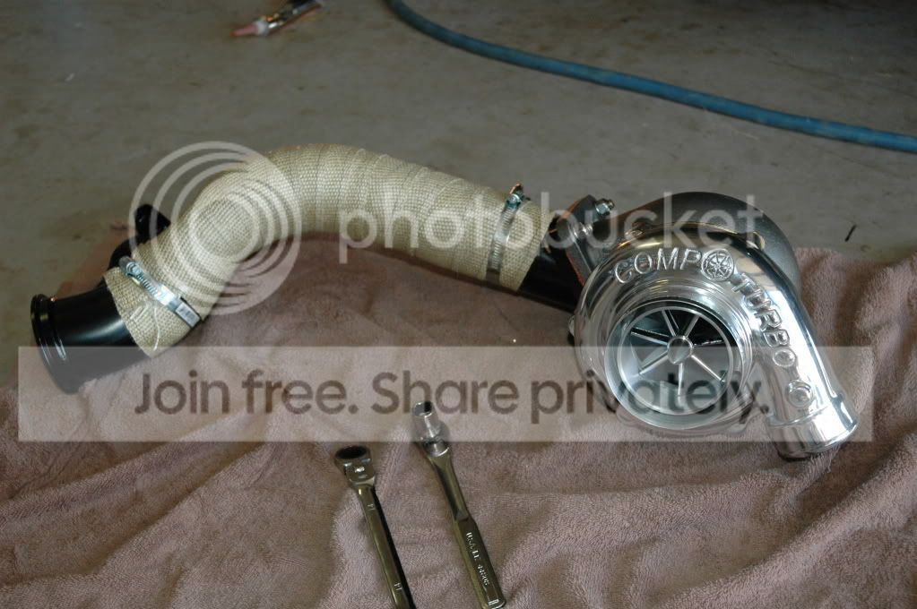

Turbo mounted prior to getting squeezed under the hood.

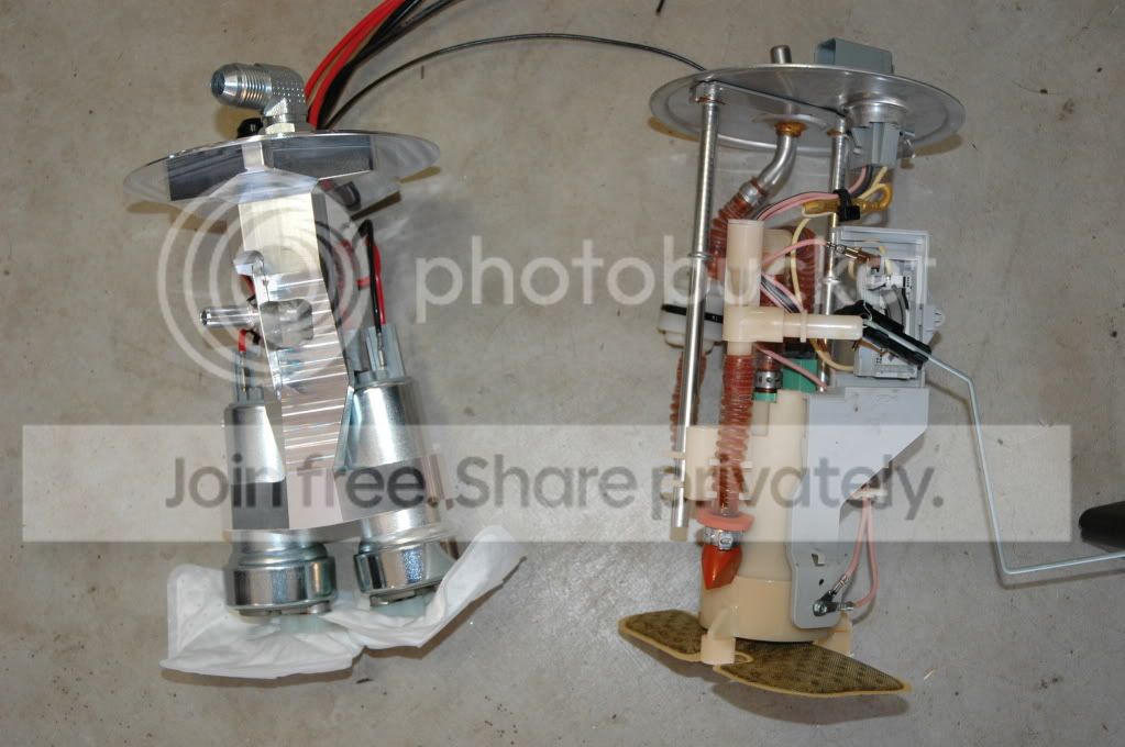

Old pump next to new

my question, any benefits to be had from the 07+ style coolant on?
I deleted the reservior itself because I just flat ran out of room. I did leave the "T" in the lower radiator line and have a 7-8" vertical (plugged) line to allow for some expansion. It is my understanding that the earlier coolant lines employed an in-line thermostate where the later ones have the thermostat in the coolant crossover. I would imagine the newer set-up is just easier to work with/around.
Not sure if that helped, lol.

Pretty much exacly, also it will perform a little better with 07+ imho. Before with the tsat inline in the lower hose it was reacting to coolant temps after being cooled by the radiator vice actual coolant temp coming out of the engine when the tstat is up top in the crossover.
