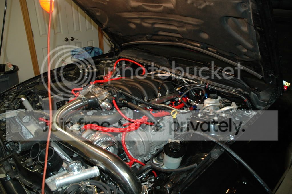

keep the pics coming.

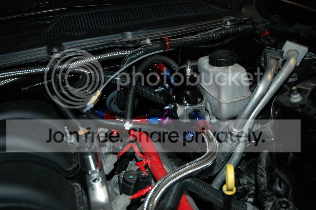

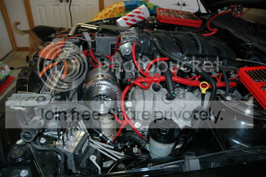

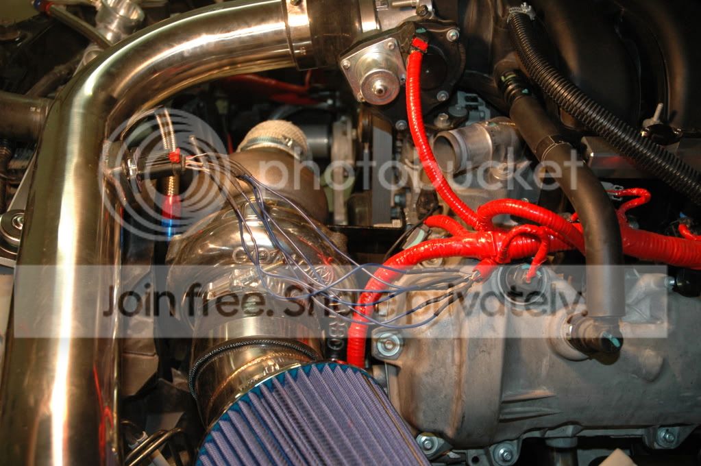

Also noticed in the pics you have a breather on the pass. side but not the drivers side. I believe if you have a breather on one side you need one on the other also.

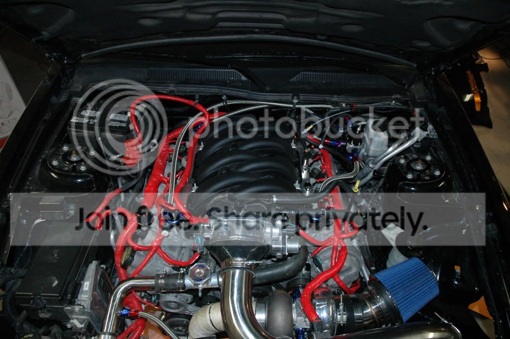

Looks very good
Looks good now send me your valve covers and I can either powder coat them what ever color or we can hydro dip them.

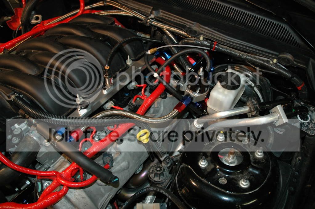

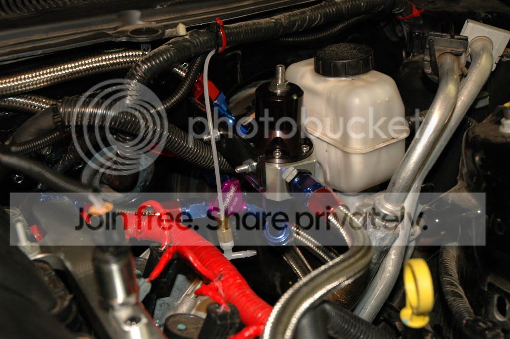

Put heavier hose clamps on your relocation kit man. I had one of my hoses blow off more than once before I replaced those clamps with heavier ones. Just giving ya a word of warning.

There is debate on having the pcv set up like that. I ran my Paxton that way when it was blow through. Everything was fine and no smoke or pcv smell. The pcv system on a 3v is designed to draw air in from the passenger side.
